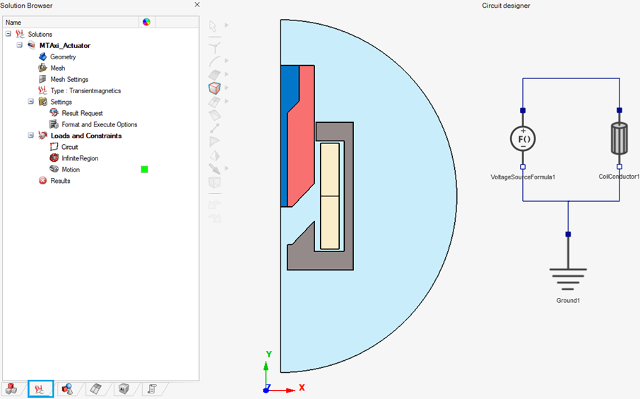

Basic EM analysis
All physics definitions of the actuator can be realized with the proposed MTAxi Workflow tool bar:

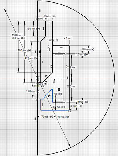

The parametrized model is created with SimLab – Sketcher, and the model can be used for further DOE analysis.
The final physical description is shown below, with a coupled circuit:

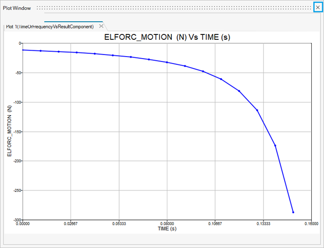

After solving the scenario, SimLab can provide some basic post-processing for the EM analysis, including the isovalue visualization and the physical quantity plotting.
