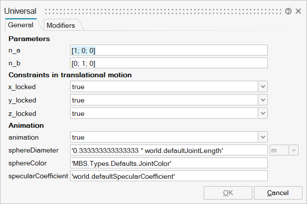

mo_n_a | n_a | Axis of revolute joint 1 resolved in frame_a | Vector of size 3 | |
mo_n_b | n_b | Axis of revolute joint 2 resolved in frame_b | Vector of size 3 | |
mo_x_locked | x_locked | = true: constraint force in x-direction, resolved in frame_a | Scalar | true |
mo_y_locked | y_locked | = true: constraint force in y-direction, resolved in frame_a | Scalar | true |
mo_z_locked | z_locked | = true: constraint force in z-direction, resolved in frame_a | Scalar | true |
mo_animation | animation | = true, if animation shall be enabled (show sphere) | Scalar | true |
mo_sphereDiameter | sphereDiameter | Diameter of sphere representing the spherical joint | Scalar | |
mo_sphereColor | sphereColor | Color of sphere representing the spherical joint | Vector of size 3 | |
mo_specularCoefficient | specularCoefficient | Reflection of ambient light (= 0: light is completely absorbed) | Scalar |

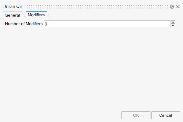

mo__modifiers/varname | Variable name | Cell of strings | 'R_rel' | |
mo__modifiers/value | Value |
