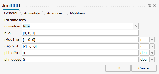

mo_animation | animation | = true, if animation shall be enabled | Scalar | true |
mo_n_a | n_a | Axes of revolute joints resolved in frame_a (all axes are parallel to each other) | Vector of size 3 | |
mo_n_b | n_b | Axis of revolute joint fixed and resolved in frame_b | Vector of size 3 | |
mo_rRod1_ia | rRod1_ia | Vector from origin of frame_a to revolute joint in the middle, resolved in frame_ia | Vector of size 3 | |
mo_rRod2_ib | rRod2_ib | Vector from origin of frame_ib to revolute joint in the middle, resolved in frame_ib | Vector of size 3 | |
mo_phi_offset | phi_offset | Relative angle offset of revolute joint at frame_b (angle = phi(t) + from_deg(phi_offset)) | Scalar | |
mo_phi_guess | phi_guess | Select the configuration such that at initial time |phi(t0) - from_deg(phi_guess)| is minimal | Scalar | |
mo_e_a | e_a | Unit vector along axes of rotations, resolved in frame_a | Vector of size 3 | |
mo_e_ia | e_ia | Unit vector along axes of rotations, resolved in frame_ia | Vector of size 3 | |
mo_e_b | e_b | Unit vector along axes of rotations, resolved in frame_b, frame_ib and frame_im | Vector of size 3 |

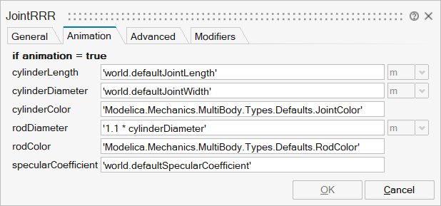

mo_cylinderLength | cylinderLength | Length of cylinders representing the revolute joints | Scalar | |
mo_cylinderDiameter | cylinderDiameter | Diameter of cylinders representing the revolute joints | Scalar | |
mo_cylinderColor | cylinderColor | Color of cylinders representing the revolute joints | Vector of size 3 | |
mo_rodDiameter | rodDiameter | Diameter of the two rods connecting the revolute joints | Scalar | |
mo_rodColor | rodColor | Color of the two rods connecting the revolute joint | Vector of size 3 | |
mo_specularCoefficient | specularCoefficient | Reflection of ambient light (= 0: light is completely absorbed) | Scalar |

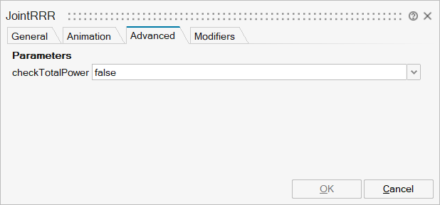

mo_checkTotalPower | checkTotalPower | = true, if total power flowing into this component shall be determined (must be zero) | Scalar | true |

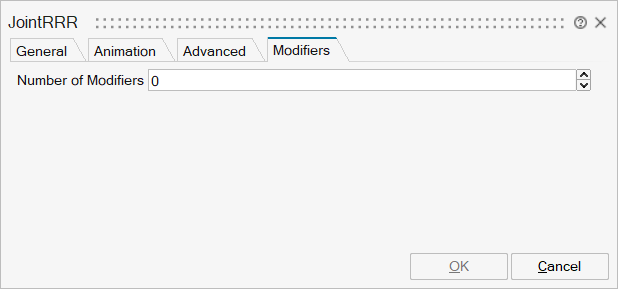

mo__modifiers/varname | Variable name | Cell of strings | 'totalPower' | |
mo__modifiers/value | Value |
