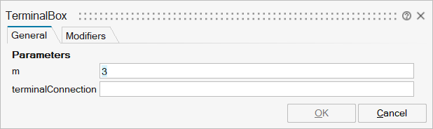

This model represents the internal connections of the terminal box of an electric machine.The parameter terminalConnection is used to switch between star(terminalConnection = "Y") and delta (terminalConnection = "D") connection.The (single-phase) connector starPoint is only available if star connection is selected.
mo_terminalConnection | terminalConnection | Choose "Y" for star or "D" for delta connection | String |

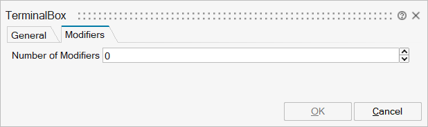

mo__modifiers/value | Value |
