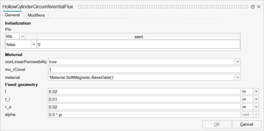

HollowCylinderCircumferentialFlux_0
mo_Phi
Phi
Phi
Structure
mo_Phi/fixed
fixed
Cell of scalars
true
false
mo_Phi/start
start
Cell of scalars
mo_nonLinearPermeability
= true, if non-linear rel. permeability is used, otherwise constant rel. permeability
Scalar
true
false
mo_mu_rConst
mu_rConst
Constant relative permeability; used if nonLinearPermeability = false
Scalar
mo_material
material
Ferromagnetic material characteristics; used if nonLinearPermeability = true
FromModelica('Modelica.Magnetic.FluxTubes.Material.SoftMagnetic.BaseData')
FromModelica('Modelica.Magnetic.FluxTubes.Material.SoftMagnetic.Steel.DC01')
FromModelica('Modelica.Magnetic.FluxTubes.Material.SoftMagnetic.Steel.DC03')
FromModelica('Modelica.Magnetic.FluxTubes.Material.SoftMagnetic.Steel.X6Cr17')
FromModelica('Modelica.Magnetic.FluxTubes.Material.SoftMagnetic.CobaltIron.Vacoflux50')
FromModelica('Modelica.Magnetic.FluxTubes.Material.SoftMagnetic.NickelIron.MuMetall')
FromModelica('Modelica.Magnetic.FluxTubes.Material.SoftMagnetic.PureIron.RFe80')
FromModelica('Modelica.Magnetic.FluxTubes.Material.SoftMagnetic.PureIron.VacoferS2')
FromModelica('Modelica.Magnetic.FluxTubes.Material.SoftMagnetic.Steel.AISI_1008')
FromModelica('Modelica.Magnetic.FluxTubes.Material.SoftMagnetic.Steel.AISI_12L14')
FromModelica('Modelica.Magnetic.FluxTubes.Material.SoftMagnetic.Steel.Steel_9SMn28K')
FromModelica('Modelica.Magnetic.FluxTubes.Material.SoftMagnetic.Steel.Steel_9SMnPb28')
FromModelica('Modelica.Magnetic.FluxTubes.Material.SoftMagnetic.ElectricSheet.M330_50A')
FromModelica('Modelica.Magnetic.FluxTubes.Material.SoftMagnetic.ElectricSheet.M350_50A')
FromModelica('Modelica.Magnetic.FluxTubes.Material.SoftMagnetic.ElectricSheet.M530_50A')
FromModelica('Modelica.Magnetic.FluxTubes.Material.SoftMagnetic.ElectricSheet.M700_100A')
FromModelica('Modelica.Magnetic.FluxTubes.Material.SoftMagnetic.ElectricSheet.M940_100A')
FromModelica('Modelica.Magnetic.FluxTubes.Material.SoftMagnetic.NickelIron.Permenorm3601K3')
mo_l
l
Width (orthogonal to flux direction)
Scalar
mo_r_i
r_i
Inner radius of hollow cylinder
Scalar
mo_r_o
r_o
Outer radius of hollow cylinder
Scalar
mo_alpha
alpha
Angle of cylinder section
Scalar

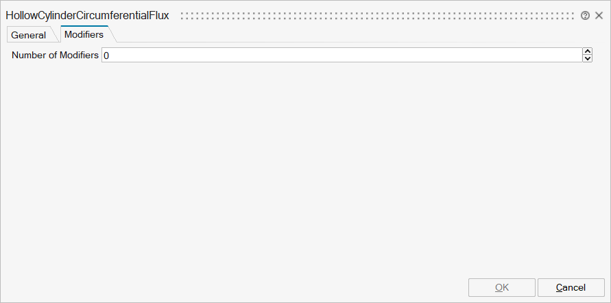

HollowCylinderCircumferentialFlux_1
mo__nmodifiers
Number of Modifiers
Specifies the number of modifiers
Number
mo__modifiers
Modifiers
Add new modifier
Structure
mo__modifiers/varname
Variable name
Cell of strings
'V_m'
'R_m'
'G_m'
'B'
'A'
'H'
'mu_r'
'B_N'
mo__modifiers/attribute
Attribute
Cell of strings
'start'
'fixed'
mo__modifiers/value
Value
