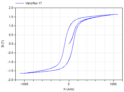

Vacoflux17
Vacoflux17

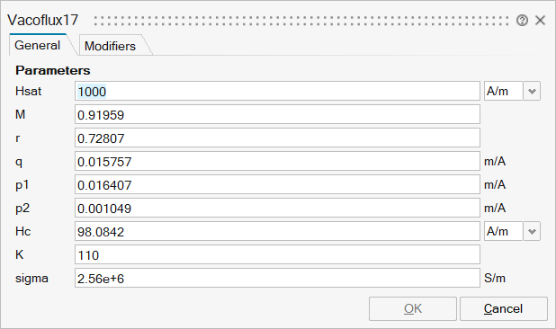

Modelica/Magnetic/FluxTubes/Material/HysteresisEverettParameter
mo_Hsat | Hsat | Hysteresis region between -Hsat .. Hsat | Scalar | |
mo_M | M | Related to saturation value of magnetization | Scalar | |
mo_r | r | Proportion of the straight region in the vicinity of Hc | Scalar | |
mo_q | q | Slope of the straight region in the vicinity of Hc | Scalar | |
mo_p1 | p1 | Sharpness of major loop | Scalar | |
mo_p2 | p2 | Sharpness of major loop | Scalar | |
mo_Hc | Hc | Major loop coercivity | Scalar | |
mo_K | K | Slope in saturation region mu_0*K | Scalar | |
mo_sigma | sigma | Electrical conductivity of material | Scalar |

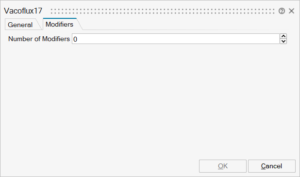

mo__modifiers/value | Value |
