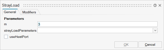

If it is desired to neglect stray load losses, set strayLoadParameters.PRef = 0 (this is the default).
mo_strayLoadParameters | strayLoadParameters | Stray load loss parameters | FromModelica('Modelica.Electrical.Machines.Losses.StrayLoadParameters') | |
mo_useHeatPort | useHeatPort | = true, if heatPort is enabled | Number | 0 |

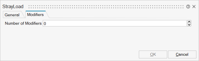

mo__modifiers/varname | Variable name | Cell of strings | 'v' | |
mo__modifiers/value | Value |
