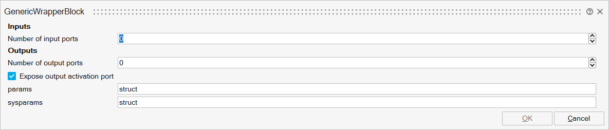

GenericWrapperBlock
This block is the basic block for all the wrappers blocks.
    GenericWrapperBlock
WrapperCodeGenerator
GenericWrapperBlock_0
nin
Number of input ports
Number
inports
Input port parameters
Structure
inports/inrow

nout
Number of output ports
Number
outports
Output port parameters

nevout
Expose output activation port
Number
0
1

params
params
sysparams
sysparams
