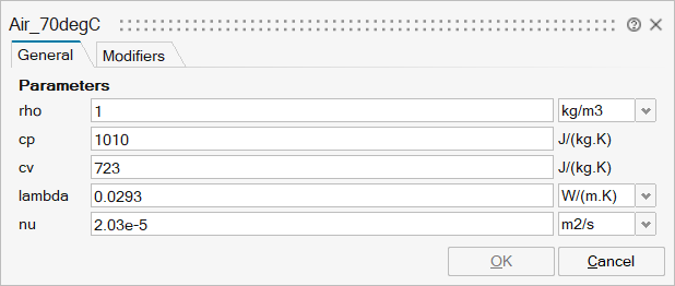

Medium: properties of air at 70°C and 1 barParameters
Name | Label | Description | Data Type | Valid Values |
mo_rho | rho | Density | Scalar | |
mo_cp | cp | Specific heat capacity at constant pressure | Scalar | |
mo_cv | cv | Specific heat capacity at constant volume | Scalar | |
mo_lamda | lamda | Thermal conductivity | Scalar | |
mo_nue | nue | Kinematic viscosity | Scalar |

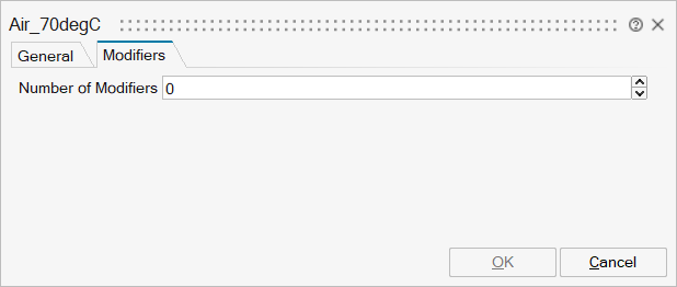

mo__modifiers/value | Value |
