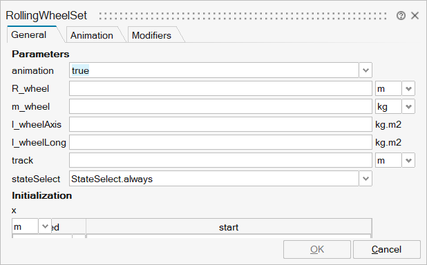

mo_animation | animation | = true, if animation of wheel set shall be enabled | Scalar | true |
mo_R_wheel | R_wheel | Radius of one wheel | Scalar | |
mo_m_wheel | m_wheel | Mass of one wheel | Scalar | |
mo_I_wheelAxis | I_wheelAxis | Inertia along one wheel axis | Scalar | |
mo_I_wheelLong | I_wheelLong | Inertia perpendicular to one wheel axis | Scalar | |
mo_track | track | Distance between the two wheels (= axle track) | Scalar | |
mo_stateSelect | stateSelect | Priority to use the generalized coordinates as states | Structure | |
mo_stateSelect/choice1 | StateSelect.never | Number | 0 | |
mo_stateSelect/choice2 | StateSelect.avoid | Number | 0 | |
mo_stateSelect/choice3 | StateSelect.default | Number | 0 | |
mo_stateSelect/choice4 | StateSelect.prefer | Number | 0 | |
mo_stateSelect/choice5 | StateSelect.always | Number | 0 | |
mo_x | x | x | Structure | |
mo_x/fixed | fixed | Cell of scalars | true | |
mo_x/start | start | Cell of scalars | ||
mo_y | y | y | Structure | |
mo_y/fixed | fixed | Cell of scalars | true | |
mo_y/start | start | Cell of scalars | ||
mo_phi | phi | phi | Structure | |
mo_phi/fixed | fixed | Cell of scalars | true | |
mo_phi/start | start | Cell of scalars | ||
mo_theta1 | theta1 | theta1 | Structure | |
mo_theta1/fixed | fixed | Cell of scalars | true | |
mo_theta1/start | start | Cell of scalars | ||
mo_theta2 | theta2 | theta2 | Structure | |
mo_theta2/fixed | fixed | Cell of scalars | true | |
mo_theta2/start | start | Cell of scalars | ||
mo_der_theta1 | der_theta1 | der_theta1 | Structure | |
mo_der_theta1/fixed | fixed | Cell of scalars | true | |
mo_der_theta1/start | start | Cell of scalars | ||
mo_der_theta2 | der_theta2 | der_theta2 | Structure | |
mo_der_theta2/fixed | fixed | Cell of scalars | true | |
mo_der_theta2/start | start | Cell of scalars |

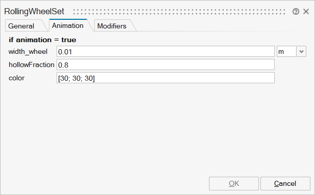

mo_width_wheel | width_wheel | Width of one wheel | Scalar | |
mo_hollowFraction | hollowFraction | For ring-like wheel visualization: wheel radius / inner hole radius; i.e. 1.0: completely hollow, 0.0: full disc | Scalar | |
mo_color | color | Color of wheels | Vector of size 3 |
