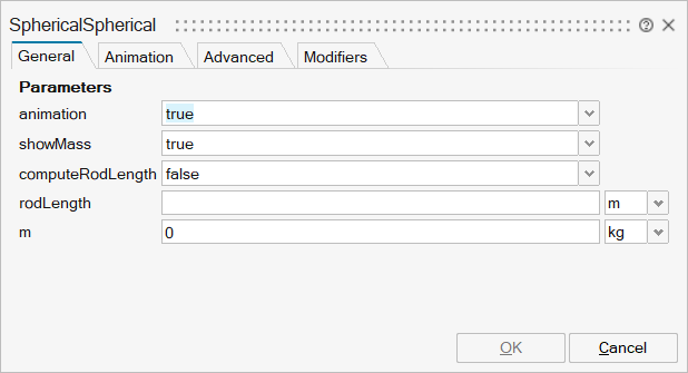

mo_computeRodLength
computeRodLength
= true, if rodLength shall be computed during initialization (see info)
Scalar
true
false
mo_rodLength
rodLength
Distance between the origins of frame_a and frame_b (if computeRodLength=true, guess value)
Scalar
mo_m
m
Mass of rod (= point mass located in middle of rod)
Scalar

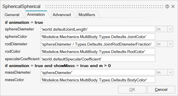

SphericalSpherical_1
mo_sphereDiameter
sphereDiameter
Diameter of spheres representing the spherical joints
Scalar
mo_sphereColor
sphereColor
Color of spheres representing the spherical joints
Vector of size 3
mo_rodDiameter
rodDiameter
Diameter of rod connecting the two spherical joint
Scalar
mo_rodColor
rodColor
Color of rod connecting the two spherical joints
Vector of size 3
mo_specularCoefficient
specularCoefficient
Reflection of ambient light (= 0: light is completely absorbed)
Scalar
mo_massDiameter
massDiameter
Diameter of sphere representing the mass point
Scalar
mo_massColor
massColor
Color of sphere representing the mass point
Vector of size 3

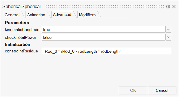

SphericalSpherical_2
mo_kinematicConstraint
kinematicConstraint
= false, if no constraint shall be defined, due to analytically solving a kinematic loop ("false" should not be used by user, but only by MultiBody.Joints.Assemblies joints)
Scalar
true
false
mo_checkTotalPower
checkTotalPower
= true, if total power flowing into this component shall be determined (must be zero)
Scalar
true
false
mo_constraintResidue
constraintResidue
Constraint equation of joint in residue form: Either length constraint (= default) or equation to compute rod force (for analytic solution of loops in combination with Internal.RevoluteWithLengthConstraint/PrismaticWithLengthConstraint)
Scalar

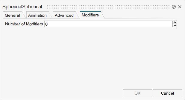

SphericalSpherical_3
mo__nmodifiers
Number of Modifiers
Number
mo__modifiers
Modifiers
Add new modifier
Structure
