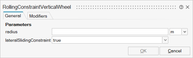

mo_radius | radius | Wheel radius | Scalar | |
mo_lateralSlidingConstraint | lateralSlidingConstraint | = true, if lateral sliding constraint taken into account, = false if lateral force = 0 (needed to avoid overconstraining if two ideal rolling wheels are connect on one axis) | Scalar | true |

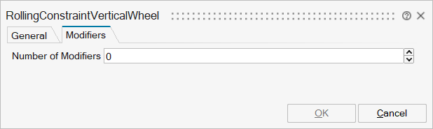

mo__modifiers/varname | Variable name | Cell of strings | 'f_wheel_0' | |
mo__modifiers/value | Value |
