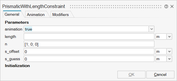

mo_animation | animation | = true, if animation shall be enabled | Scalar | true |
mo_length | length | Fixed length of length constraint | Scalar | |
mo_n | n | Axis of translation resolved in frame_a (= same as in frame_b) | Vector of size 3 | |
mo_s_offset | s_offset | Relative distance offset (distance between frame_a and frame_b = s(t) + s_offset) | Scalar | |
mo_s_guess | s_guess | Select the configuration such that at initial time |s(t0)-s_guess| is minimal | Scalar | |
mo_positiveBranch | positiveBranch | Selection of one of the two solutions of the non-linear constraint equation | Scalar | true |
mo_e | e | Unit vector in direction of translation axis, resolved in frame_a | Vector of size 3 | |

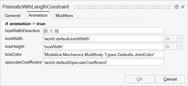

mo_boxWidthDirection | boxWidthDirection | Vector in width direction of box, resolved in frame_a | Vector of size 3 | |
mo_boxWidth | boxWidth | Width of prismatic joint box | Scalar | |
mo_boxHeight | boxHeight | Height of prismatic joint box | Scalar | |
mo_boxColor | boxColor | Color of prismatic joint box | Vector of size 3 | |
mo_specularCoefficient | specularCoefficient | Reflection of ambient light (= 0: light is completely absorbed) | Scalar |

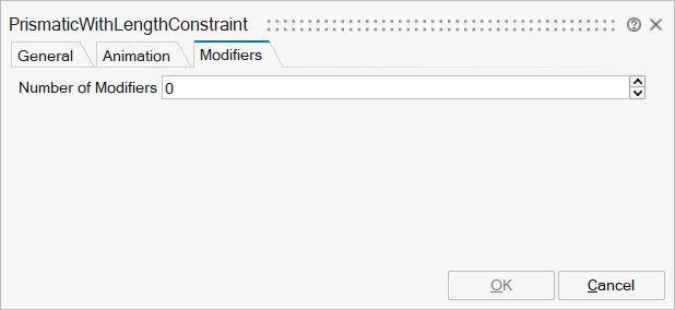

mo__modifiers/varname | Variable name | Cell of strings | 's' | |
mo__modifiers/value | Value |
