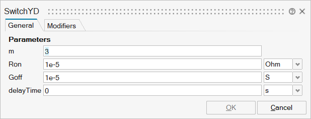

Simple Star-Delta-switch.If control is false, plug_sp and plug_sn are star connected and plug_sp connected to the supply plug.
If control is true, plug_sp and plug_sn are delta connected and they are connected to the supply plug.
mo_Ron | Ron | Closed switch resistance | Scalar | |
mo_Goff | Goff | Opened switch conductance | Scalar | |
mo_delayTime | delayTime | Time delay | Scalar |

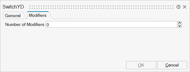

mo__modifiers/value | Value |
