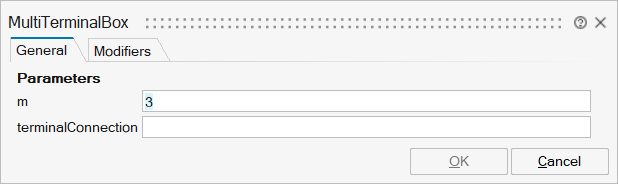

This model represents the internal connections of the terminal box of an electric machine.The parameter terminalConnection is used to switch between star(terminalConnection = "Y") and delta (terminalConnection = "D") connection.
The connector starPoint is only available if star connection is selected.This connector is a plug withmSystem = Electrical.Polyphase.Functions.numberOfSymmetricBaseSystems(m) phases,representing the star points of each base system; seeModelica.Magnetic.FundamentalWave.UsersGuide.Polyphase.
mo_mSystems | mSystems | Number of symmetric base systems | Scalar | |
mo_mBasic | mBasic | Number of phases of basic system | Scalar | |
mo_terminalConnection | terminalConnection | Choose "Y" for star or "D" for delta connection | String |
