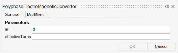

PolyphaseElectroMagneticConverter_0
mo_m
m
Number of phases
Scalar
mo_effectiveTurns
effectiveTurns
Effective number of turns
Scalar
mo_N
N
Complex effective number of turns
Scalar
mo_sTM
sTM
Matrix
mo_indexNonPos
indexNonPos
Indices of all non positive sequence components
Vector
mo_indexPos
indexPos
Indices of all positive sequence components
Vector

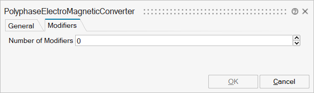

PolyphaseElectroMagneticConverter_1
mo__nmodifiers
Number of Modifiers
Number
mo__modifiers
Modifiers
Add new modifier
Structure
mo__modifiers/varname
Variable name
Cell of strings
'abs_v'
'arg_v'
'abs_i'
'arg_i'
'P'
'P_total'
'Q'
'Q_total'
'S'
'S_total'
'pf'
'abs_V_m'
'arg_V_m'
'abs_Phi'
'arg_Phi'
'omega'
mo__modifiers/attribute
Attribute
Cell of strings
'start'
'fixed'
mo__modifiers/value
Value
