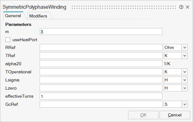

mo_useHeatPort | useHeatPort | Enable / disable (=fixed temperatures) thermal port | Number | 0 |
mo_RRef | RRef | Winding resistance per phase at TRef | Scalar | |
mo_TRef | TRef | Reference temperature of winding | Scalar | |
mo_alpha20 | alpha20 | Temperature coefficient of winding at 20 degC | Scalar | |
mo_alphaRef | alphaRef | Temperature coefficient of winding at reference temperature | Scalar | |
mo_TOperational | TOperational | Operational temperature of winding | Scalar | |
mo_Lsigma | Lsigma | Winding stray inductance per phase | Scalar | |
mo_Lzero | Lzero | Zero sequence inductance of winding | Scalar | |
mo_effectiveTurns | effectiveTurns | Effective number of turns per phase | Scalar | |
mo_GcRef | GcRef | Electrical reference core loss reluctance | Scalar | |
mo_nBase | nBase | Number of base systems | Scalar | |
mo_mBase | mBase | Number of phase of the base systems | Scalar |

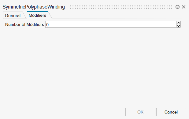

mo__modifiers/varname | Variable name | Cell of strings | 'v' | |
mo__modifiers/value | Value |
