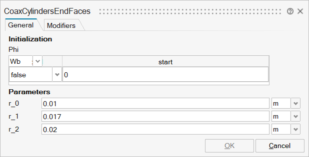

mo_r_0 | r_0 | Radius of inner solid cylinder | Scalar | |
mo_r_1 | r_1 | Inner radius of outer hollow cylinder | Scalar | |
mo_r_2 | r_2 | Outer radius of outer hollow cylinder | Scalar | |
mo_l_g | l_g | Radial gap length between both cylinders | Scalar | |
mo_t | t | Radial thickness of outer hollow cylinder | Scalar |

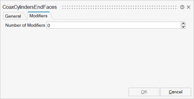

mo__modifiers/varname | Variable name | Cell of strings | 'V_m' | |
mo__modifiers/value | Value |
