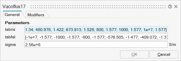

Vacoflux17
Vacoflux17

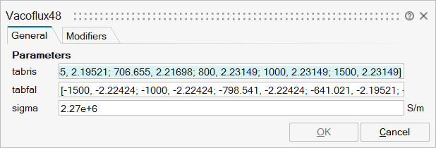

Modelica/Magnetic/FluxTubes/Material/HysteresisTableData
mo_tabris | tabris | Table data of the rising (lower) branch of the hysteresis envelope curve (H, B) | Matrix | |
mo_tabfal | tabfal | Table data of the falling (upper) branch of the hysteresis envelope curve (H, B) | Matrix | |
mo_sigma | sigma | Electric conductivity | Scalar |

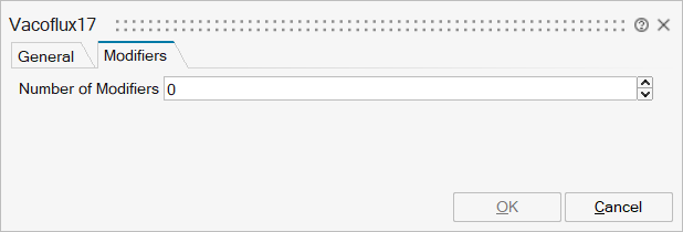

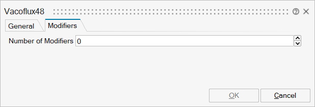

mo__modifiers/value | Value |
