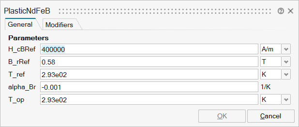

Please refer to the description of the enclosing package HardMagnetic for a description of all permanent magnetic material characteristics of this package.
mo_H_cBRef | H_cBRef | Coercivity at reference temperature | Scalar | |
mo_B_rRef | B_rRef | Remanence at reference temperature | Scalar | |
mo_T_ref | T_ref | Reference temperature | Scalar | |
mo_alpha_Br | alpha_Br | Temperature coefficient of remanence at reference temperature | Scalar | |
mo_T_op | T_op | Operating temperature | Scalar | |
mo_B_r | B_r | Remanence at operating temperature | Scalar | |
mo_H_cB | H_cB | Coercivity at operating temperature | Scalar | |
mo_mu_r | mu_r | Relative permeability | Scalar |

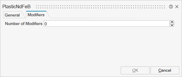

mo__modifiers/value | Value |
