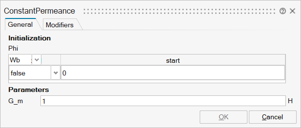

This constant permeance is provided for test purposes and simple magnetic network models. The permeance is not calculated from geometry and permeability of a flux tube, but is provided as parameter.
mo_Phi | Phi | Phi | Structure | |
mo_Phi/fixed | fixed | Cell of scalars | true | |
mo_Phi/start | start | Cell of scalars | ||
mo_G_m | G_m | Magnetic permeance | Scalar |

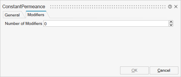

mo__modifiers/varname | Variable name | Cell of strings | 'V_m' | |
mo__modifiers/value | Value |
