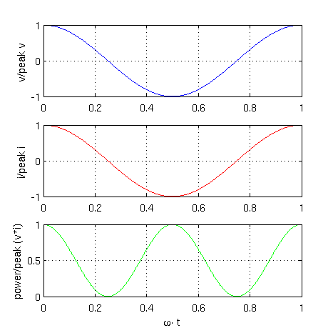

Power of a resistor
The instantaneous voltage and current are in phase:
Therefore, the instantaneous power is
A graphical representation of these equations is depicted in Fig. 1
Fig. 1: Instantaneous voltage, current of power of a resistor
Real power of the resistor is the average of instantaneous power:

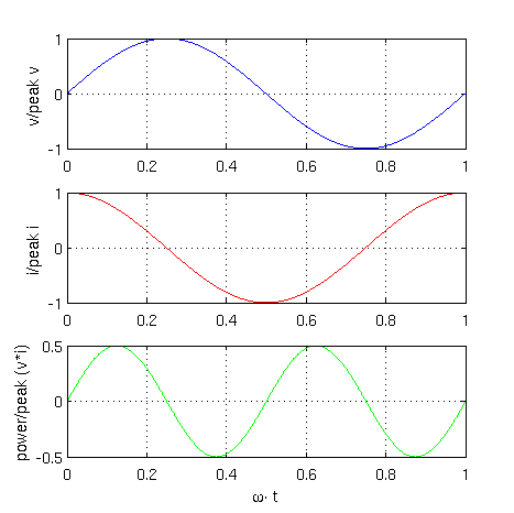

Power of an inductor
The instantaneous voltage leads the current by a quarter of the period:
A graphical representation of these equations is depicted in Fig. 2
Fig. 2: Instantaneous voltage, current of power of an inductor
Reactive power of the inductor is:

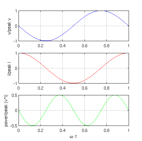

Power of a capacitor
The instantaneous voltage lags the current by a quarter of the period:
A graphical representation of these equations is depicted in Fig. 3
Fig. 3: Instantaneous voltage, current of power of a capacitor
Reactive power of the capacitor is:
