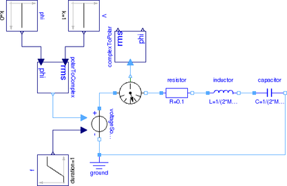

A simple example of a series connection of a resistor, an inductor and a capacitoras depicted in Fig. 1 should be explained in the following. For various frequencies,the voltage drops across the resistor, the inductor and the capacitor should be determined.
Fig. 1: Series AC circuit of a resistor and an inductor at variable frequency
