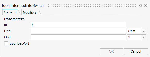

Contains m ideal intermediate switches (Modelica.Electrical.QuasiStatic.SinglePhase.Ideal.IdealIntermediateSwitch).
Use with care:This switch is only intended to be used for structural changes, not fast switching sequences, due to the quasi-static formulation.
mo_Ron | Ron | Closed switch resistance | Vector | |
mo_Goff | Goff | Opened switch conductance | Vector | |
mo_mh | mh | Number of heatPorts=number of phases | Scalar | |
mo_useHeatPort | useHeatPort | = true, if all heat ports are enabled | Number | 0 |
mo_T | T | Fixed device temperatures if useHeatPort = false | Vector |

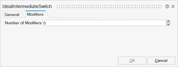

mo__modifiers/value | Value |
control | implicit | true => p1--n2, p2--n1 connected, otherwise p1--n1, p2--n2 connected | input | 1 |
