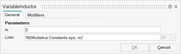

Contains m variable inductors (Modelica.Electrical.Analog.Basic.VariableInductor)
It is required that each L_Port.signal ≥ 0, otherwise anassertion is raised. To avoid a variable index system,
L = Lmin, if 0 ≤ L_Port.signal < Lmin, whereLmin is a parameter with default value Modelica.Constants.eps.
mo_Lmin | Lmin | Minimum inductance | Vector |
mo__modifiers/varname | Variable name | Cell of strings | 'v' | |
mo__modifiers/value | Value |
