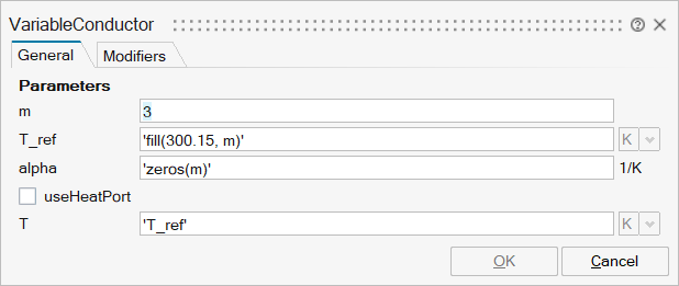

VariableConductor
Ideal linear electrical conductors with variable conductance
Modelica/Electrical/Polyphase/Basic
Contains m variable conductors (Modelica.Electrical.Analog.Basic.VariableConductor)
Attention!!!
It is recommended that none of the G_Port signals should not cross the zero value. Otherwise depending on the surrounding circuit the probability of singularities is high.
mo_T_ref | T_ref | Reference temperatures | Vector | |
mo_alpha | alpha | Temperature coefficients of conductances at reference temperatures | Vector | |
mo_mh | mh | Number of heatPorts=number of phases | Scalar | |
mo_useHeatPort | useHeatPort | = true, if all heat ports are enabled | Number | 0 |
mo_T | T | Fixed device temperatures if useHeatPort = false | Vector |

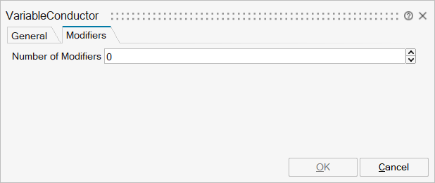

mo__modifiers/varname | Variable name | Cell of strings | 'v' | |
mo__modifiers/value | Value |
