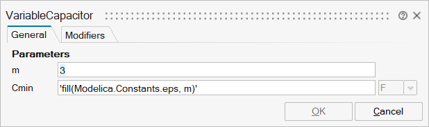

Contains m variable capacitors (Modelica.Electrical.Analog.Basic.VariableCapacitor)
It is required that each C_Port.signal ≥ 0, otherwise anassertion is raised. To avoid a variable index system,
C = Cmin, if 0 ≤ C_Port.signal < Cmin, whereCmin is a parameter with default value Modelica.Constants.eps.
mo_Cmin | Cmin | Minimum capacitance | Vector |

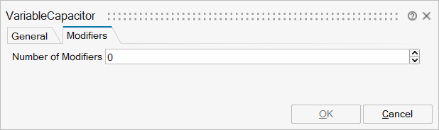

mo__modifiers/varname | Variable name | Cell of strings | 'v' | |
mo__modifiers/value | Value |
