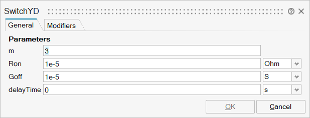

Simple Star-Delta-switch.If control is false, plug_sp and plug_sn are star connected and plug_sp connected to the supply plug.
If control is true, plug_sp and plug_sn are delta connected and they are connected to the supply plug.
mo_m | m | Number of phases | Scalar |
plugSupply | implicit | To grid | input | 1 |
plug_sp | implicit | To positive stator plug | input | 2 |
plug_sn | implicit | To negative stator plug | output | 1 |
control | implicit | input | 3 |
