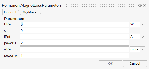

Parameter record for permanent magnet losses.
mo_PRef | PRef | Reference permanent magnet losses at IRef and wRef | Scalar | |
mo_c | c | Part of permanent magnet losses at current = 0, i.e. independent of current | Scalar | |
mo_IRef | IRef | Reference stator RMS current that PRef refers to | Scalar | |
mo_power_I | power_I | Exponent of permanent magnet loss torque w.r.t. stator current | Scalar | |
mo_wRef | wRef | Reference angular velocity that PRef refers to | Scalar | |
mo_power_w | power_w | Exponent of permanent magnet loss torque w.r.t. angular velocity | Scalar | |
mo_tauRef | tauRef | Reference permanent magnet loss torque at reference angular velocity and reference current | Scalar |
