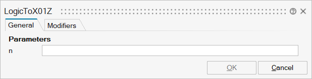

LogicToX01Z_0
mo_n
n
signal width
Scalar

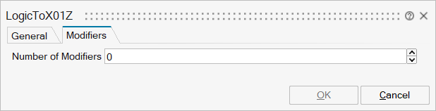

LogicToX01Z_1
mo__nmodifiers
Number of Modifiers
Number
mo__modifiers
Modifiers
Add new modifier
Structure
mo__modifiers/varname
Variable name
Cell of strings
mo__modifiers/attribute
Attribute
Cell of strings
'start'
'fixed'
mo__modifiers/value
Value
x
implicit
input
1
y
implicit
output
1
