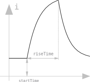

This current source uses the corresponding signal source of the Modelica.Blocks.Sources package. Care for the meaning of the parameters in the Blocks package. Furthermore, an offset parameter is introduced, which is added to the value calculated by the blocks source. The startTime parameter allows to shift the blocks source behavior on the time axis.

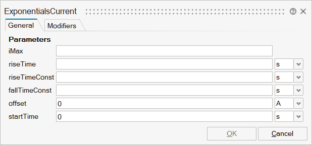

Name | Label | Description | Data Type | Valid Values |
mo_iMax | iMax | Upper bound for rising edge | Scalar | |
mo_riseTime | riseTime | Rise time | Scalar | |
mo_riseTimeConst | riseTimeConst | Rise time constant | Scalar | |
mo_fallTimeConst | fallTimeConst | Fall time constant | Scalar | |
mo_offset | offset | Current offset | Scalar | |
mo_startTime | startTime | Time offset | Scalar |

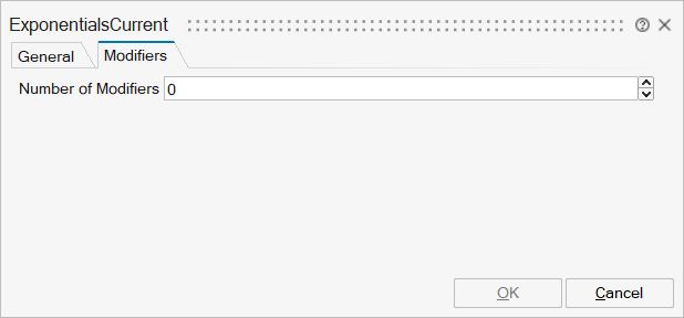

mo__modifiers/varname | Variable name | Cell of strings | 'v' | |
mo__modifiers/value | Value |
