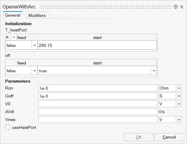

Name | Label | Description | Data Type | Valid Values |
mo_T_heatPort | T_heatPort | T_heatPort | Structure | |
mo_T_heatPort/fixed | fixed | Cell of scalars | true | |
mo_T_heatPort/start | start | Cell of scalars | ||
mo_off | off | off | Structure | |
mo_off/fixed | fixed | Cell of scalars | true | |
mo_off/start | start | Cell of scalars | true | |
mo_quenched | quenched | quenched | Structure | |
mo_quenched/fixed | fixed | Cell of scalars | true | |
mo_quenched/start | start | Cell of scalars | true | |
mo_tSwitch | tSwitch | tSwitch | Structure | |
mo_tSwitch/fixed | fixed | Cell of scalars | true | |
mo_tSwitch/start | start | Cell of scalars | ||
mo_Ron | Ron | Closed switch resistance | Scalar | |
mo_Goff | Goff | Opened switch conductance | Scalar | |
mo_V0 | V0 | Initial arc voltage | Scalar | |
mo_dVdt | dVdt | Arc voltage slope | Scalar | |
mo_Vmax | Vmax | Max. arc voltage | Scalar | |
mo_useHeatPort | useHeatPort | = true, if heatPort is enabled | Number | 0 |
mo_T | T | Fixed device temperature if useHeatPort = false | Scalar |

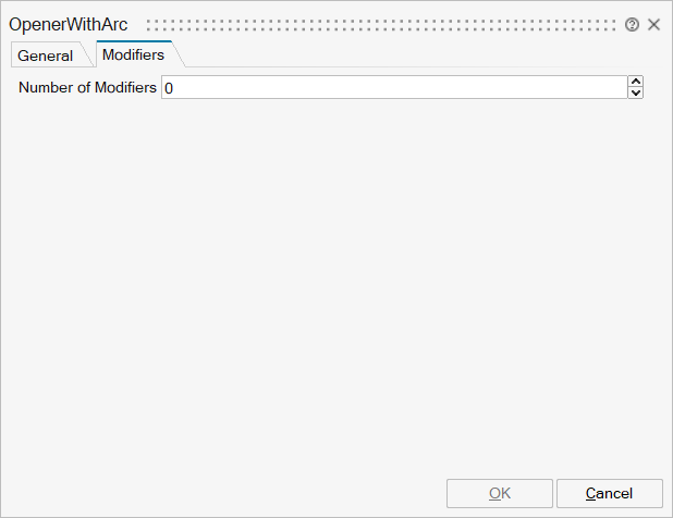

mo__modifiers/varname | Variable name | Cell of strings | 'v' | |
mo__modifiers/value | Value |
