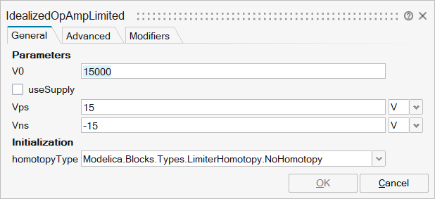

Name | Label | Description | Data Type | Valid Values |
mo_V0 | V0 | No-load amplification | Scalar | |
mo_useSupply | useSupply | Use supply pins (otherwise constant supply) | Number | 0 |
mo_Vps | Vps | Positive supply voltage | Scalar | |
mo_Vns | Vns | Negative supply voltage | Scalar | |
mo_homotopyType | homotopyType | Simplified model for homotopy-based initialization | Structure | |
mo_homotopyType/choice1 | Modelica.Blocks.Types.LimiterHomotopy.NoHomotopy | Number | 0 | |
mo_homotopyType/choice2 | Modelica.Blocks.Types.LimiterHomotopy.Linear | Number | 0 | |
mo_homotopyType/choice3 | Modelica.Blocks.Types.LimiterHomotopy.UpperLimit | Number | 0 | |
mo_homotopyType/choice4 | Modelica.Blocks.Types.LimiterHomotopy.LowerLimit | Number | 0 |

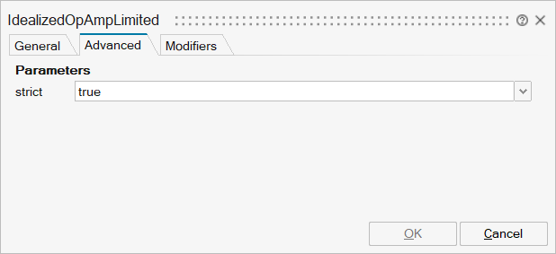

mo_strict | strict | = true, if strict limits with noEvent(..) | Scalar | true |

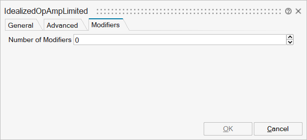

Name | Type | Description | IO Type | Number |
in_p | implicit | Positive pin of the input port | input | 1 |
in_n | implicit | Negative pin of the input port | output | 1 |
out | implicit | Pin of the output port | input | 2 |
Port 4 | implicit | Optional positive supply pin | input | mo_useSupply |
Port 5 | implicit | Optional negative supply pin | output | mo_useSupply |
