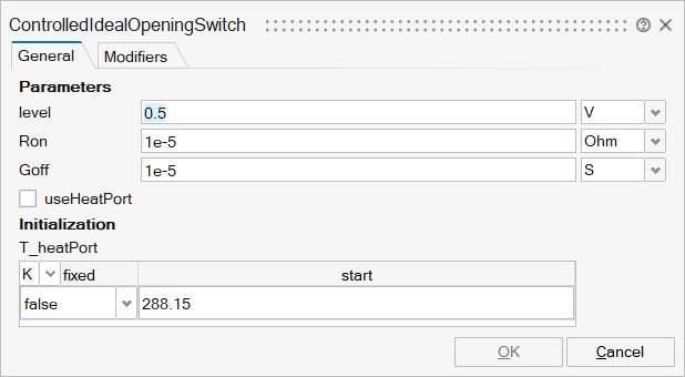

Name | Label | Description | Data Type | Valid Values |
mo_level | level | Switch level | Scalar | |
mo_Ron | Ron | Closed switch resistance | Scalar | |
mo_Goff | Goff | Opened switch conductance | Scalar | |
mo_useHeatPort | useHeatPort | = true, if heatPort is enabled | Number | 0 |
mo_T | T | Fixed device temperature if useHeatPort = false | Scalar | |
mo_T_heatPort | T_heatPort | T_heatPort | Structure | |
mo_T_heatPort/fixed | fixed | Cell of scalars | true | |
mo_T_heatPort/start | start | Cell of scalars |

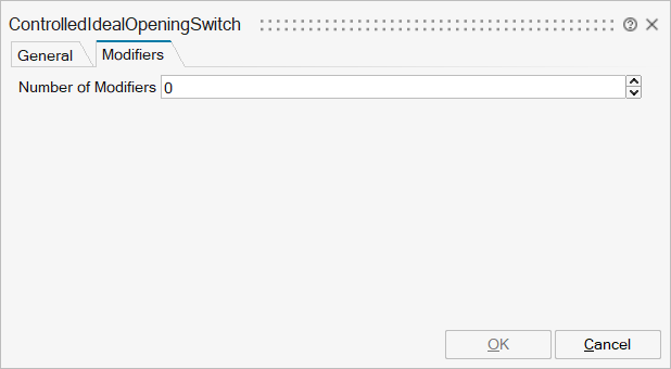

mo__modifiers/varname | Variable name | Cell of strings | 'v' | |
mo__modifiers/value | Value |
Name | Type | Description | IO Type | Number |
p | implicit | Positive electrical pin | input | 1 |
n | implicit | Negative electrical pin | output | 1 |
control | implicit | Control pin: control.v > level switch open, otherwise p--n connected | input | 2 |
Port 4 | implicit | Conditional heat port | input | mo_useHeatPort |
