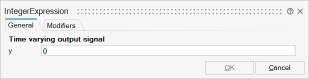

Set output signal to a time varying Integer expression
Modelica/Blocks/Sources
The (time varying) Integer output signal of this block can be defined in itsparameter menu via variable y. The purpose is to support theeasy definition of Integer expressions in a block diagram. For example,in the y-menu the definition "if time < 1 then 0 else 1" can be given in orderto define that the output signal is one, if time ≥ 1 and otherwiseit is zero. Note, that "time" is a built-in variable that is alwaysaccessible and represents the "model time" and thatvariable y is both a variable and a connector.
mo_y | y | Value of Integer output | Scalar |
y | implicit | Value of Integer output | output | 1 |
