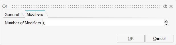

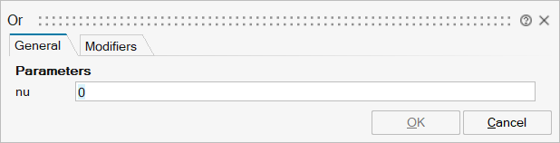

mo_nu | nu | Number of input connections | Scalar |
mo__modifiers/value | Value |
