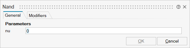

Name | Label | Description | Data Type | Valid Values |
mo_nu | nu | Number of input connections | Scalar |

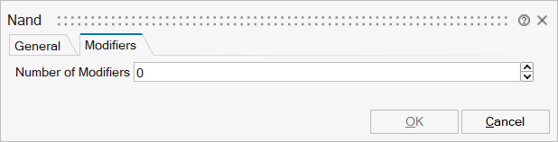

mo__modifiers/value | Value |
