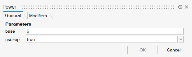

mo_base | base | Base of power | Scalar | |
mo_useExp | useExp | Use exp function in implementation | Scalar | true |
