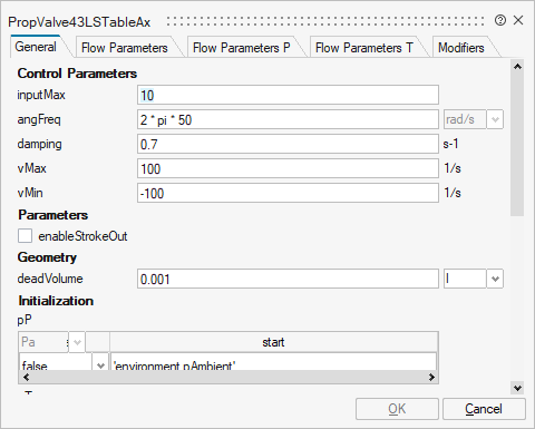

mo_inputMax | inputMax | Input value for 100 % open | Scalar | |
mo_angFreq | angFreq | Angular frequency | Scalar | |
mo_damping | damping | Damping | Scalar | |
mo_vMax | vMax | max. Velocity | Scalar | |
mo_vMin | vMin | min. Velocity | Scalar | |
mo_enableStrokeOut | enableStrokeOut | Enable Stroke Output | Number | 0 |
mo_inputMaxPartial | inputMaxPartial | Scalar | ||
mo_forwardFluidPropertiesBT | forwardFluidPropertiesBT | Scalar | true | |
mo_deadVolume | deadVolume | Dead volume at ports | Scalar | |
mo_pP | pP | pP | Structure | |
mo_pP/fixed | fixed | Cell of scalars | true | |
mo_pP/start | start | Cell of scalars | ||
mo_pT | pT | pT | Structure | |
mo_pT/fixed | fixed | Cell of scalars | true | |
mo_pT/start | start | Cell of scalars | ||
mo_pA/start | start | Cell of scalars | ||
mo_pB | pB | pB | Structure | |
mo_pB/fixed | fixed | Cell of scalars | true | |
mo_pB/start | start | Cell of scalars | ||
mo_pLS | pLS | pLS | Structure | |
mo_pLS/fixed | fixed | Cell of scalars | true | |
mo_pLS/start | start | Cell of scalars | ||
mo_initType | initType | Type of initialization (1: no init, 2: steady state, 3/4: initial output) | Structure | |
mo_initType/choice1 | Modelica.Blocks.Types.Init.NoInit | Number | 0 | |
mo_initType/choice2 | Modelica.Blocks.Types.Init.SteadyState | Number | 0 | |
mo_initType/choice3 | Modelica.Blocks.Types.Init.InitialState | Number | 0 | |
mo_initType/choice4 | Modelica.Blocks.Types.Init.InitialOutput | Number | 0 | |
mo_Stroke | Stroke | Stroke | Structure | |
mo_Stroke/fixed | fixed | Cell of scalars | true | |
mo_Stroke/start | start | Cell of scalars | ||
mo_Velocity | Velocity | Velocity | Structure | |
mo_Velocity/fixed | fixed | Cell of scalars | true | |
mo_Velocity/start | start | Cell of scalars |

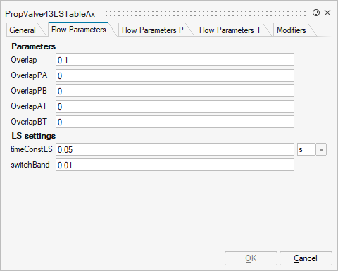

mo_Overlap | Overlap | Valve edge general relative overlap | Scalar | |
mo_OverlapPA | OverlapPA | Valve edge PA relative overlap | Scalar | |
mo_OverlapPB | OverlapPB | Valve edge PB relative overlap | Scalar | |
mo_OverlapAT | OverlapAT | Valve edge AT relative overlap | Scalar | |
mo_OverlapBT | OverlapBT | Valve edge BT relative overlap | Scalar | |
mo_timeConstLS | timeConstLS | Time constant of LS signal | Scalar | |
mo_switchBand | switchBand | Relative stroke at which the LS port is switched | Scalar |

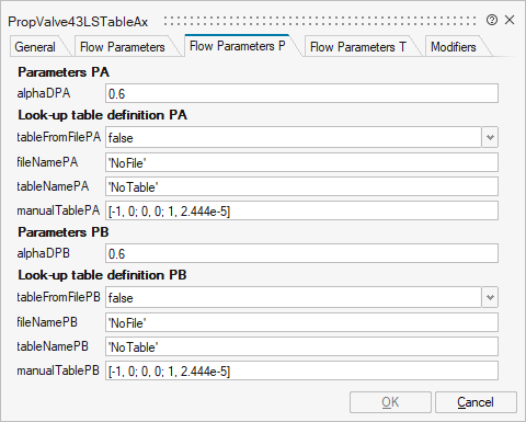

mo_alphaDPA | alphaDPA | Flow coefficient alphaD | Scalar | |
mo_tableFromFilePA | tableFromFilePA | Table is provided by file | Scalar | true |
mo_fileNamePA | fileNamePA | File where look-up table is stored | String | |
mo_tableNamePA | tableNamePA | Table name on file | String | |
mo_manualTablePA | manualTablePA | Manually provided look-up table | Matrix | |
mo_alphaDPB | alphaDPB | Flow coefficient alphaD | Scalar | |
mo_tableFromFilePB | tableFromFilePB | Table is provided by file | Scalar | true |
mo_fileNamePB | fileNamePB | File where look-up table is stored | String | |
mo_tableNamePB | tableNamePB | Table name on file | String | |
mo_manualTablePB | manualTablePB | Manually provided look-up table | Matrix |

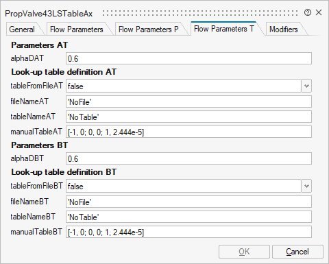

mo_alphaDAT | alphaDAT | Flow coefficient alphaD | Scalar | |
mo_tableFromFileAT | tableFromFileAT | Table is provided by file | Scalar | true |
mo_fileNameAT | fileNameAT | File where look-up table is stored | String | |
mo_tableNameAT | tableNameAT | Table name on file | String | |
mo_manualTableAT | manualTableAT | Manually provided look-up table | Matrix | |
mo_alphaDBT | alphaDBT | Flow coefficient alphaD | Scalar | |
mo_tableFromFileBT | tableFromFileBT | Table is provided by file | Scalar | true |
mo_fileNameBT | fileNameBT | File where look-up table is stored | String | |
mo_tableNameBT | tableNameBT | Table name on file | String | |
mo_manualTableBT | manualTableBT | Manually provided look-up table | Matrix |

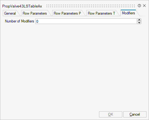

mo__modifiers/varname | Variable name | Cell of strings | 'volumeFlowP' | |
mo__modifiers/value | Value |
