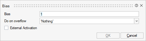

Bias
The Bias block adds a constant to the input to produce the output.
Activate/MathOperations
Output is computed as follows: y = u + Bias , where Bias is the block parameter.
The Bias can be a scalar or a matrix. If a matrix, its size must match the size of the block input.
b | Bias | The Bias is a real value. | Matrix | |
over | Do on overflow | String | 'Nothing' | |
externalActivation | External Activation | Number | 0 |
Port 1 | explicit | input | 1 | |
Port 2 | explicit | output | 1 | |
Port 3 | activation | input | externalActivation |
