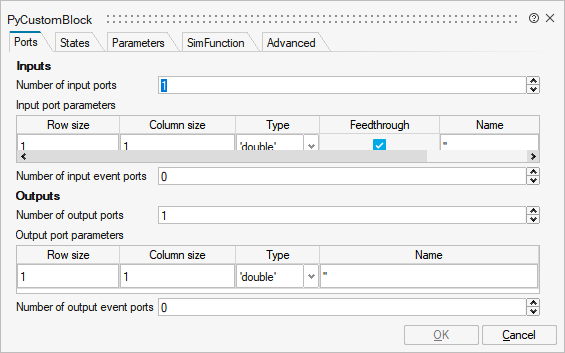

PyCustomBlock_0
nin
Number of input ports
inports
Input port parameters
Structure
inports/inrow
Row size
Cell of scalars
inports/incol
Column size
Cell of scalars
inports/it
Type
Cell of strings
'double'
'complex'
'int32'
'int16'
'int8'
'uint32'
'uint16'
'uint8'
'boolean'
inports/depu
Feedthrough
Cell of scalars
inports/name
Name
Cell of strings
nevin
Number of input event ports
nout
Number of output ports
outports
Output port parameters
Structure
outports/outrow
Row size
Cell of scalars
outports/outcol
Column size
Cell of scalars
outports/ot
Type
Cell of strings
'double'
'complex'
'int32'
'int16'
'int8'
'uint32'
'uint16'
'uint8'
'boolean'
outports/name
Name
Cell of strings
nevout
Number of output event ports
evoutports
Initial firing values
Structure
evoutports/fir
Firing (<0 for no firing)
Cell of scalars

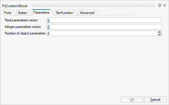

rpar
Real parameters vector
Vector
ipar
Integer parameters vector
Vector
nopar
Number of object parameters
oparparams
Object parameters
Structure
oparparams/opartyp
Type
Cell of strings
'double'
'complex'
'int32'
'int16'
'int8'
'uint32'
'uint16'
'uint8'
'boolean'
'int64'
'uint64'
'string'
oparparams/oparvalue
Value
oparparams/name
Name
Cell of strings
PyCustomBlock_3

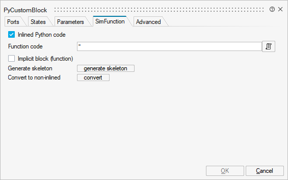

inlined
Inlined Python code
code
Function code
fcn
Function
Structure
fcn/slib
Python file path
Cell of strings
fcn/epoint
Python function name
Cell of strings
impl
Implicit block (function)

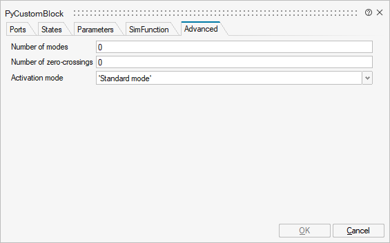

PyCustomBlock_4
nmode
Number of modes
nzcr
Number of zero-crossings
dept
Activation mode
'Always
Active
mode'
'Initially
Active
mode'
'Standard
mode'
