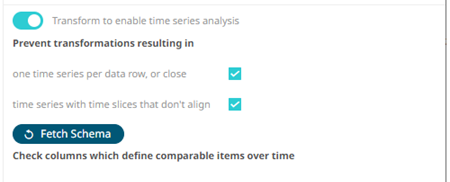

  3. Tap the Transform to enable Time Series analysis slider to turn it on.
    NOTE: Once enabled, the Transform Settings  button displays with a check . If the transform leads to change in the schema, the Fetch Schema  button is also enabled.
    The check boxes for: one time series per data row, or close and time series with time slices that don’t align, ensure that duplicate values are highlighted, and the time cube volume is minimized.
  4. Click Fetch Schema   to update columns available for time series transform.

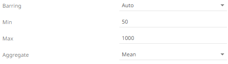

  8. Choose whether you want to Conflate the dataset by setting the Barring period to Auto, or a defined value, between Year and Nanosecond.
    Setting the barring period conflates the dataset to a defined granularity, returning a set number of data points, by default being between 50 and 1000 for Auto.
    As data is potentially being aggregated across time, an Aggregate must be selected.  The default conflation aggregate is Mean. Other options include: Sum, Min, Max, First,  Last and Count.

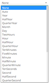

    The available barring periods besides Auto are:
    Year, Half Year, Quarter Year, Month, Day, Two Hours, Hour, Half Hour, Quarter Hour, Ten Minutes, Five Minutes, Minute, Half Minute, Quarter Minute, Ten Seconds, Second, Half Second, Quarter Second, Tenth Second, Fifty Milliseconds, Ten Milliseconds, Five Milliseconds, Millisecond, Fifty Microseconds, Ten Microseconds, Five Microseconds, Microsecond, Fifty Nanoseconds, Ten Nanoseconds, Five Nanoseconds, Nanosecond.

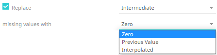

  9. Choose whether you want to interpolate for missing values.
    The interpolation can replace missing numeric values with Zero, the Previous Value, or an interpolation between known values (Interpolated).

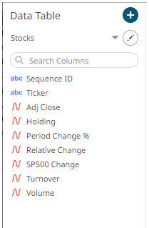

  11. Click    then   to save the data table and exit the Data Table Editor  layout. On the Open Workbook in Design Mode, a time series data table is visually identified by the time series curve to the left of any numeric time series fields.
