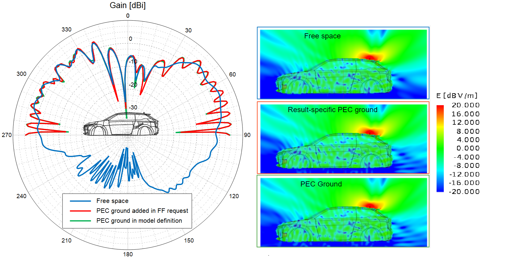

  • Different ground configurations can now be evaluated in a single simulation by specifying result-specific ground planes. Result-specific ground planes can be specified for far fields, near fields, SAR, and receiving antenna requests when the ground plane for the model is set to No ground. The impact of the ground plane(s) on the results is only considered during post-processing. When using result-specific ground planes, the back coupling of ground reflection to current distribution on the structure is neglected. Note that result-specific ground planes are not supported with RL-GO for 2025.
    For PEC, PMC and homogenous half-space ground planes (including result-specific ground planes), any Z-value (height) can now be specified. An example would be a vehicle with an antenna above a metallic plane. In the past, the workflow would have been to translate the vehicle to the correct height; now the height of the ground plane can be modified instead.
    Figure 1. Evaluate the near field and far field for a cellular antenna on a vehicle for f = 960 MHz​. Three configurations were examined: the vehicle in free space, the vehicle with a result-specific PEC ground plane, and the vehicle with a PEC ground plane in model definition.

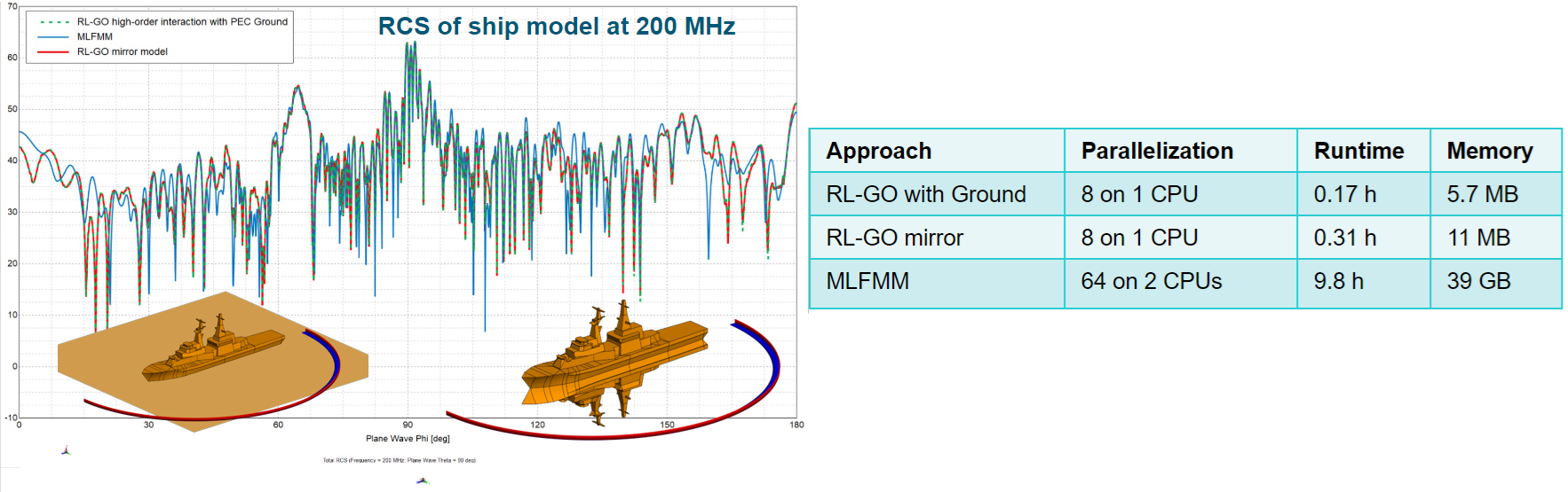

  • RL-GO was extended and now supports:

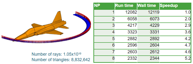

    • Multiple GPU usage for parallel MPI RL-GO runs when using manual settings.​ This results in a huge speedup for RL-GO solutions with multiple diffractions interactions.
      Figure 2. An example showing the speedup when using multiple GPUs for RL-GO.
    • Higher-order interactions with PEC, PMC or homogeneous half-space (reflection coefficient approximation) infinite ground plane.
      Figure 3. An example showing the speedup when using RL-GO with an infinite plane.

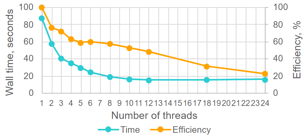

  • PREFEKO can now use multiple threads when preparing a .fek file for simulation. This can significantly impact overall runtime when performing many simulations (optimization or parameter sweep) or for large .pre files. The efficiency beyond 8 processors is low.
    Figure 4. An example using 15.7 million triangles and 642 MB .fek file size.

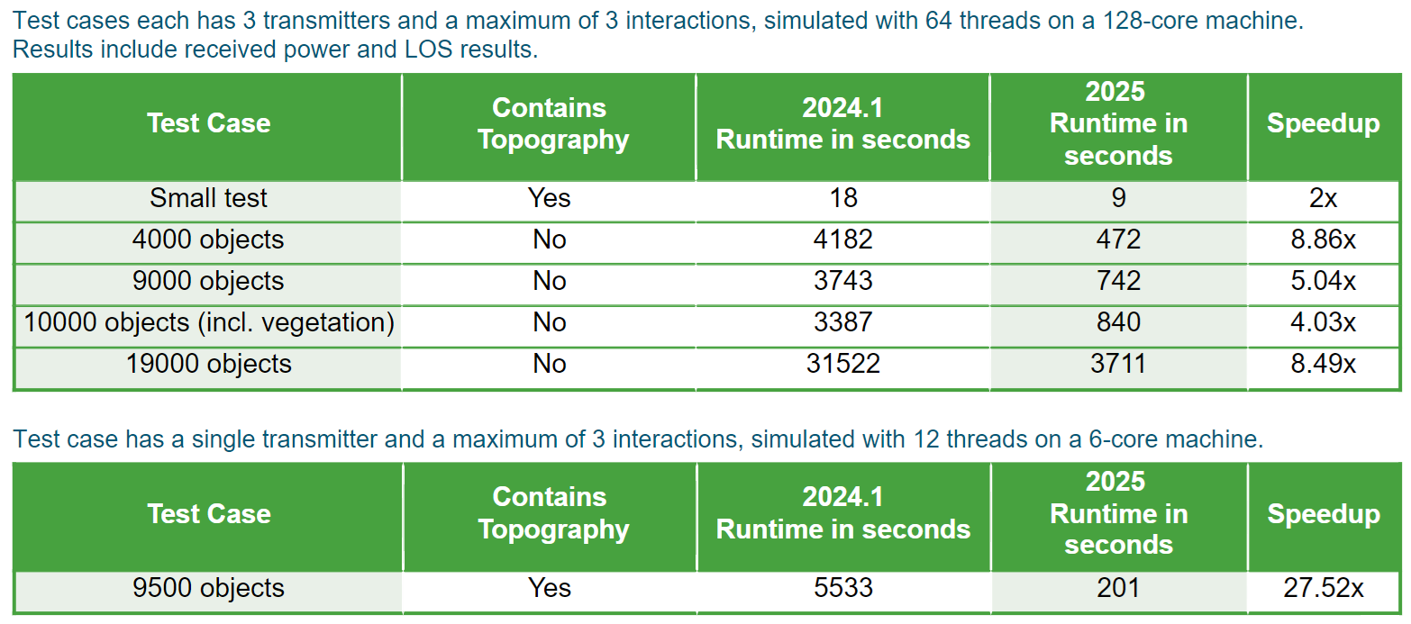

  • Accelerated the Intelligent Ray Tracing (IRT) model for urban scenarios in point/trajectory mode.
    Figure 5. Test cases comparing the runtime between 2024.1 and 2025.

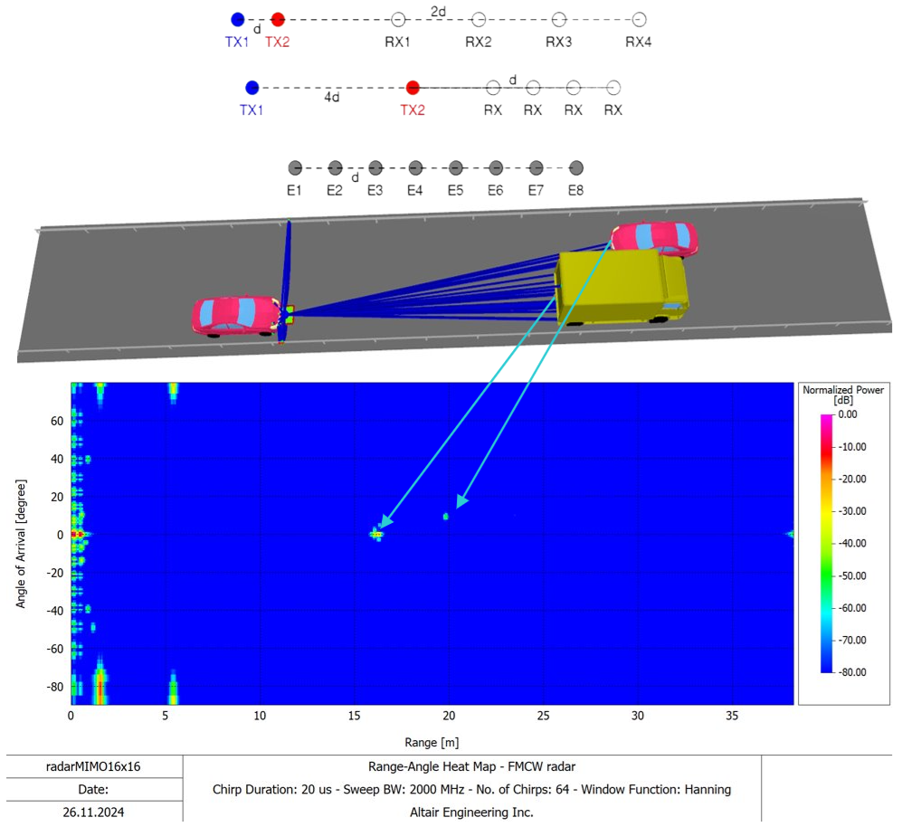

  • A MIMO antenna configuration can now be specified in the FMCW radar. With N transmitting and M receiving antenna elements, a virtual antenna array of N*M elements can be generated with proper antenna placement. The angle resolution is improved by the multiplicative increase in the number of (virtual) antenna elements.
    Figure 6. An example of a range-angle heat map showing the MIMO antenna configuration.

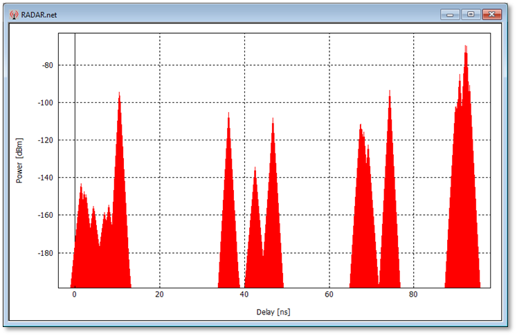

  • The power delay profile can now be displayed where the triangle pulse width is specified in nanoseconds.
    Figure 7. An example of a power delay profile plot.

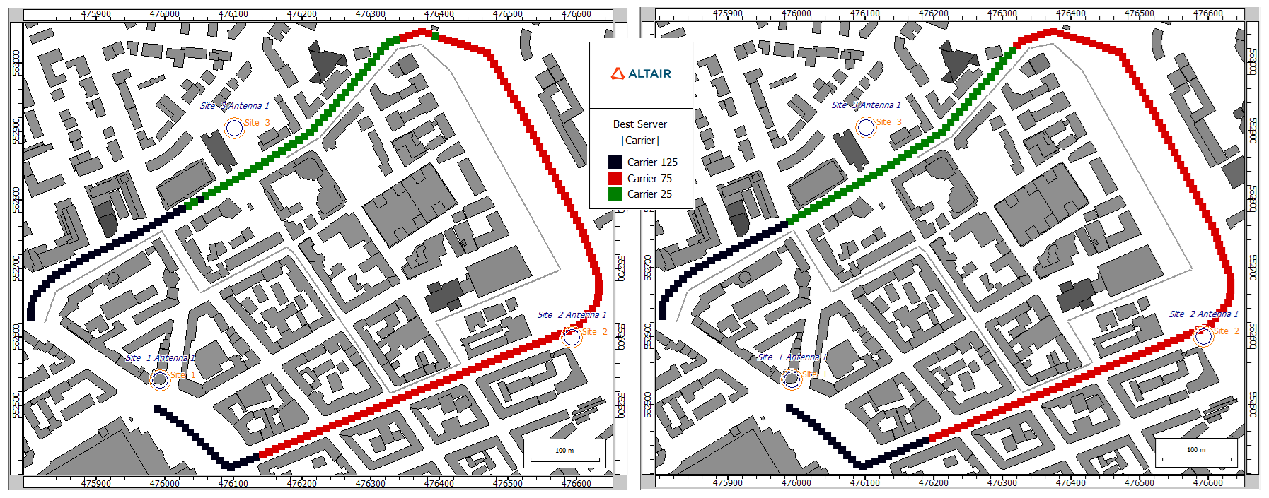

  • The handover process for the cell assignment can now be considered for trajectory mode. The handover to the new serving cell is only performed if the received signal level (or RSRP/RSRQ, depending on the selected cell assignment criteria) is the defined handover offset [dB] higher for a period longer than the defined TTT (time to trigger) interval [ms].
    Figure 8. Left is an example of the best server without handover, and right is the best server with handover.
