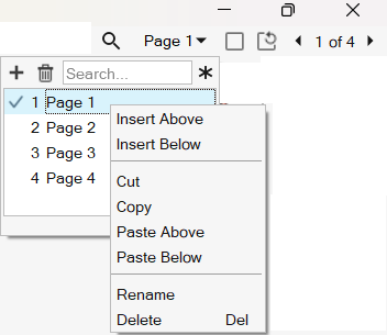

Create and Modify Pages
Create pages or modify an existing page's properties, such as name, publish settings, and layout.
In the Session Browser, right-click and select
Create from the context menu.
A new page is created, and the Entity Editor opens with the page's corresponding properties.
- In the Entity Editor, edit the page's properties.
- Adds a page with the default layout.
- Deletes the selected page(s).
- Search Field
- Enter your search criteria and press Enter to search for a specific page
- Insert Above
- Inserts a new page above the selected page in the list.
- Insert Below
- Inserts a new page below the selected page in the list.
- Cut
- Copies the selected page to the clipboard and removes it from the list.
- Copy
- Copies the selected page to the clipboard, with the page remaining in the list.
- Paste Above
- Pastes the cut or copied page directly above the selected page in the list.
- Paste Below
- Pastes the cut or copied page directly below the selected page in the list.
- Rename
- Renames a page.
- Delete
If you have not cut nor copied a page, then the Paste Above and Paste Below options are disabled.

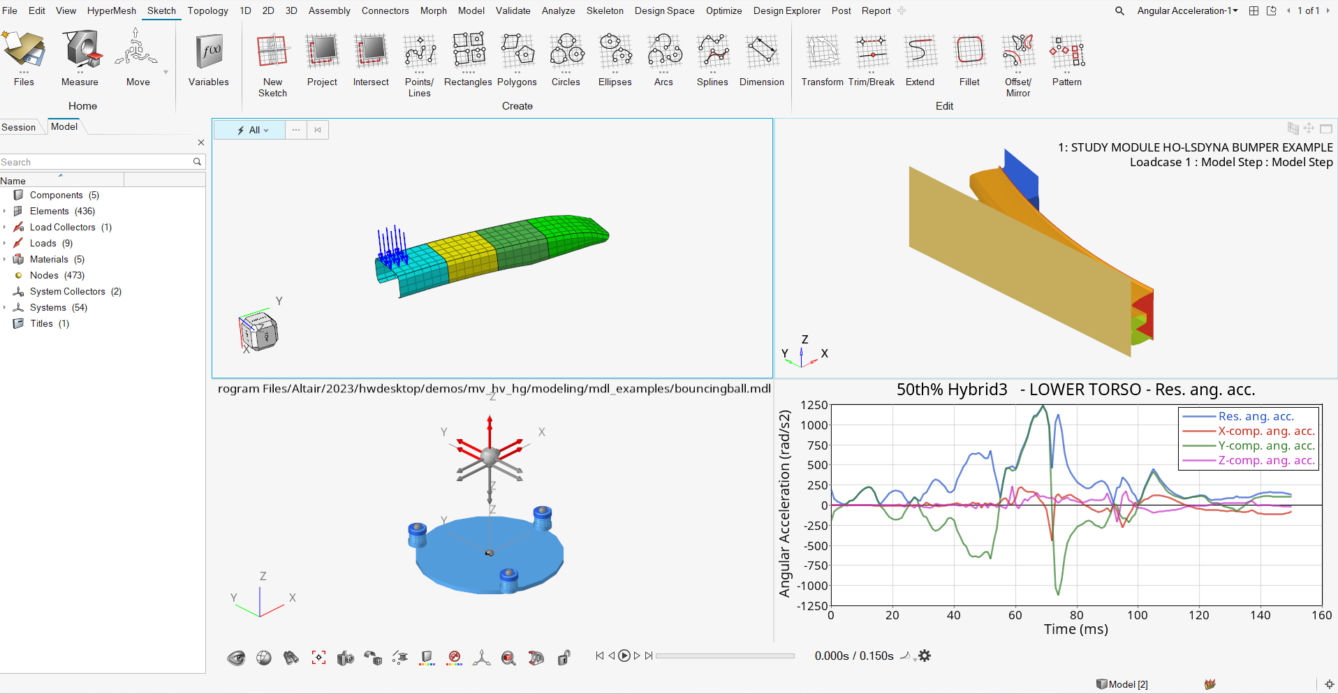

Change Page Layout
Change the layout of each page to suit your needs.
A typical layout might consist of a large window on the left displaying an animation with two smaller windows on the right tracking relevant data points on corresponding plots. There are 20 possible page arrangements.
The default layout is a single window; however a different default layout can be specified using the *SetDefaultPageLayout() statement in the preferences.mvw file.
Click
(Page Layout) on the page navigation tools.
Select a layout from the list of options.
Figure 3. Page Layout Menu
