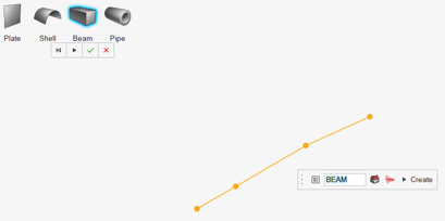

    1. Left-click in the modeling window to select a point or node until you are able to create a beam.
    2. After selecting more than two points, a microdialog is displayed that you can use to assign properties, , and damping, .
      Figure 3.
      Figure 4.

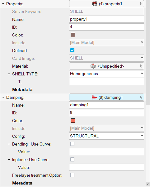

    3. Specify the name in the field.
    4. Click and assign properties and damping, respectively. Click when finished.
    5. Click Create to create a beam.

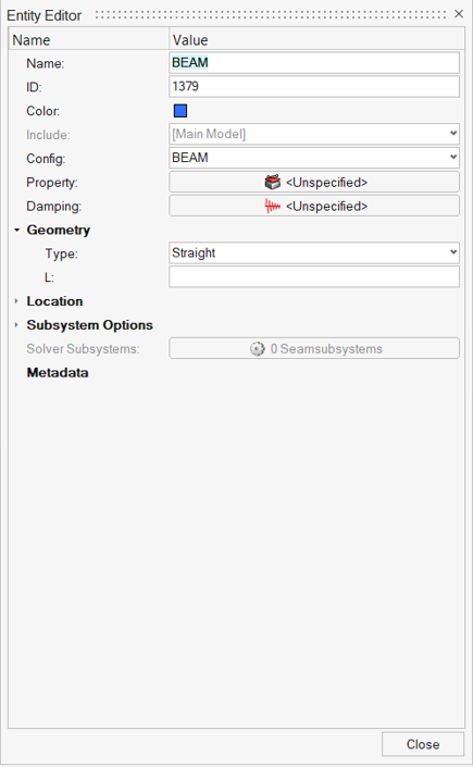

  3. From the microdialog, click to edit the subsystem and update the parameters.
    Figure 6.
    Figure 7. Beam Entity Editor
    Name
    Specify unique name.
    ID
    Specify unique ID.
    Config
    Specify the element type.
    Property
    Specify the property parameter based on the element type.
    Damping
    Specify damping to the subsystem.
    Geometry
    Based on the element type, update the geometry parameters.

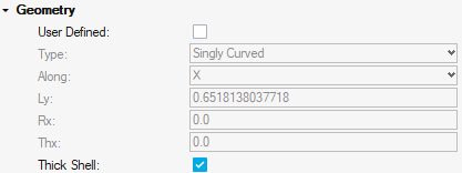

    Generally, the geometry is automatically updated from the user-defined geometry. You can modify the geometry information by clicking User Defined as shown below.
