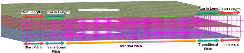

Run In Length
The length of the transitional area between the Start/End Pitch and the Internal Pitch.
Start Length/End Length
Start Length and End Length are the lengths that the Start Pitch and End Pitch affect, respectively.
Start Pitch/End Pitch
Start Pitch and End Pitch are the pitch values of the Start Length and End Length, respectively.
Internal Pitch
The pitch value of the intermediate area (between the start and end lengths).
Single End
The End Length and End Pitch options are removed, and the Internal Pitch affects the whole of the remaining length.

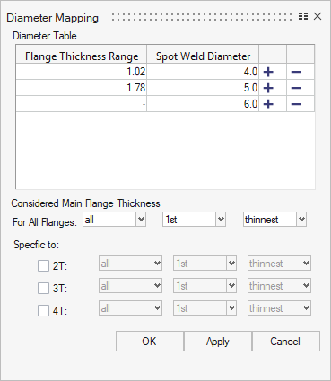

Diameter mapping file
Obtain diameter values that you assigned to a range of flange thicknesses in the Diameter Table.
Along with flange thickness ranges, you can also specify the main flange thicknesses to consider when assigning diameter values.
Figure 5.

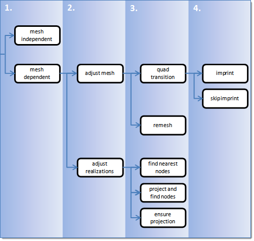

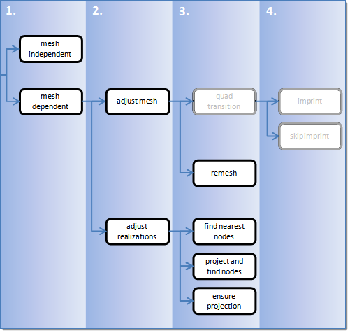

Figure 6. Outline of the Four-Stage Process Used to Select the Best Routine for Point and Line Realizations
Figure 7. Outline of the Three-Stage Process Used to Select the Best Routine for Area Realizations

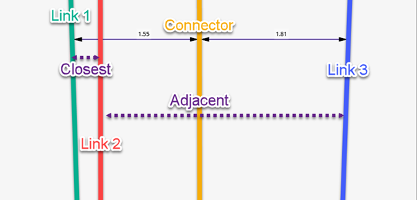

Link Option (Line/Area)
Closest
Uses the links closest to the connector by distance.
Adjacent
Uses the links adjacent to the connector.
Normal deviation
Deviation allowed for the projection.
Two links only
Selects only two links from the connector links.
Figure 8.

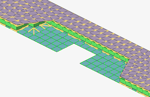

Auto Trim (Area)
Automatically trims the connector area realization where no projection exist.
Figure 9. Area Connector, locations without projection
Figure 10. Realized Area Connector with Auto Trim ON

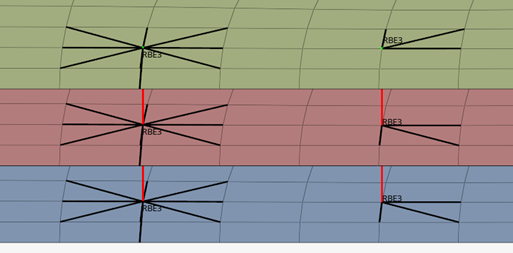

Rbe3 Radius
Every point realization that uses RBE3 elements as the head, had the Rbe3 Radius option available, which can change the number of independent nodes.
Figure 11.
Options
Rbe3 Radius
Defines a circle with the specified diameter within which all nodes will be connected to the RBE3 as independent nodes.
Rbe3 Radius Center
Specifies whether the center of each RBE3 will be considered individually or the RBE3 cluster center will be used (for Hexa (Rigid) only).
Feature Angle
Defines the angle at which nodes will stop being considered in the RBE3.
Rbe3 Weight Factor
Specifies the weighing method for the RBE3s.
Inverse distance
The distance from the center of the RBE3 to a node, is inversely proportional to the weight that will be assigned to that node.
Normal distance
The distance from the center of the RBE3 to a node, is proportional to the weight that will be assigned to that node.
Equal
The weight that will be assigned to the RBE3 node is equal to the value you have specified.
Normalize Rbe3 Weights
Specifies if the weights of the RBE3s will sum up to 1.
