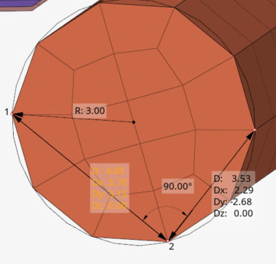

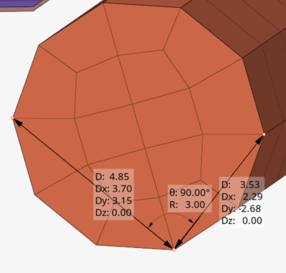

  3. Draw lines to measure length, angles, and radii.
    • Measure length by left-clicking on geometry to create start and end points.
    • Measure an angle or the radius of a circle by drawing two lines that start or end at the same point.
  4. Extract additional information from the measurements in the following ways:
    • Click on a length measurement to expand or collapse the individual measurement components (Dx, Dy, Dz).
    • Right-click on a measurement to copy individual line items or all measurement values in a selected label. When you copy all, the component labels are retained so you can distinguish between the values. When you copy an individual component, only the value is kept. This way you can quickly paste into another field.
    • Right-click on the radius value to show/hide the circle that represents the three points contained within the two length measurements.
    • Hover over a length measurement to view the start (1) and end (2) points of the line. This gives you a reference for the component values.
    • Hover over a curved line to view the line length.

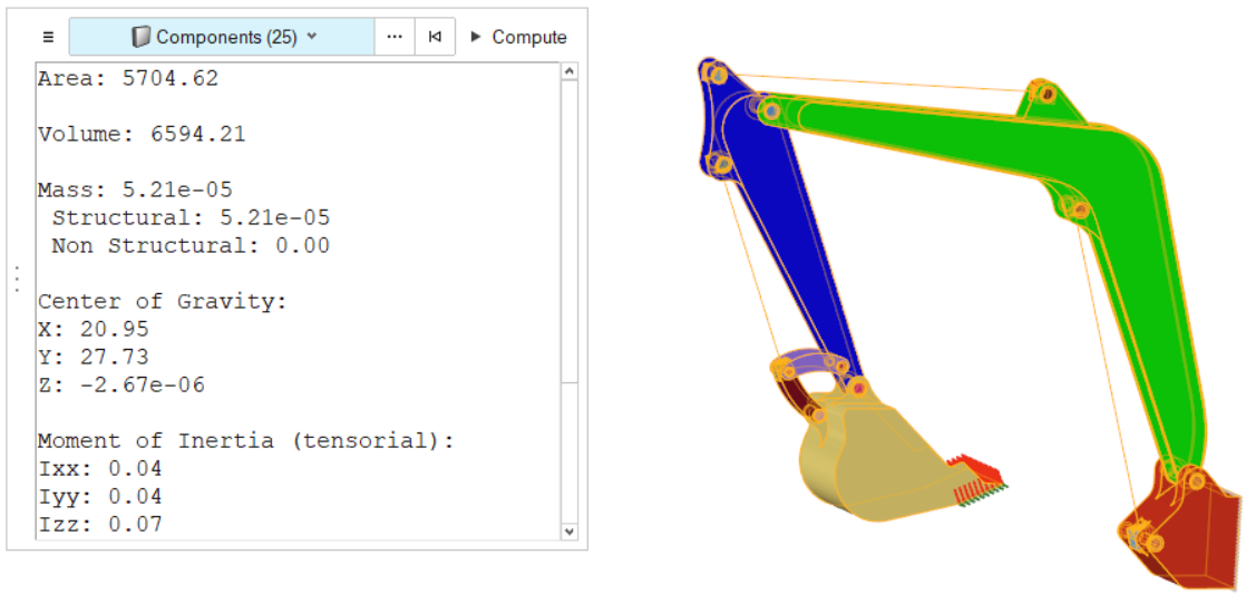

Calculate Summary Measurements
Summary measurements include areas, volumes, centers of gravity, bounding boxes, and the cumulative lengths of lines.
  1. From the NVH Tools ribbon, click the Measure tool satellite icon.
    Figure 4.

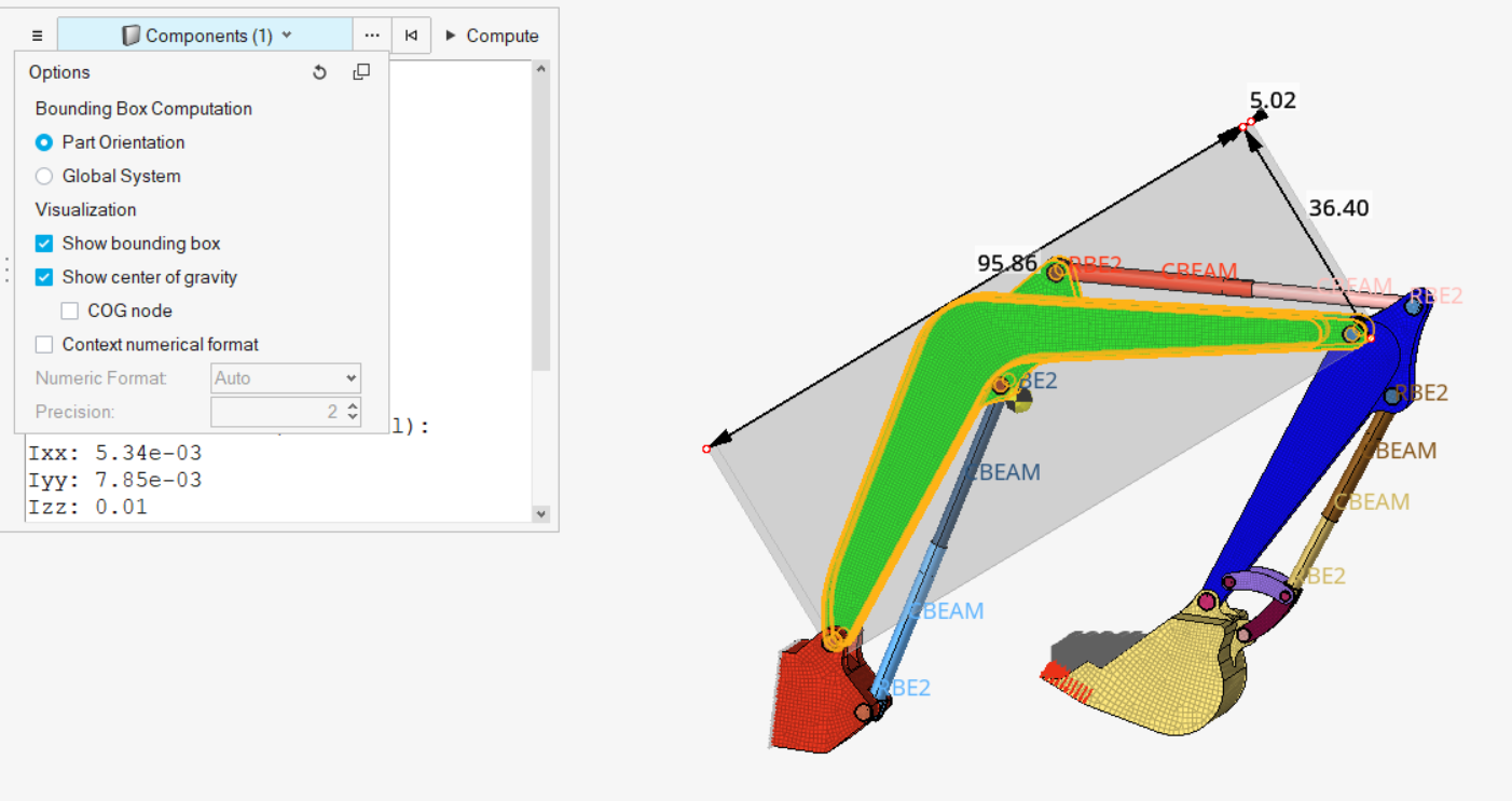

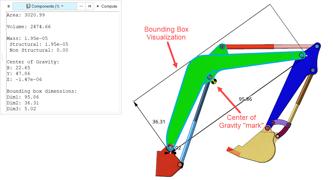

  2. Optional: Click in the microdialog to adjust bounding box orientation and visualization options, such as plotting the center of gravity (COG) and optionally creating a node at the COG location.
  3. Select entities to measure in the modeling window.
    The supported entity types are: components, elements, solids, surfaces, assemblies, and lines.
    Based on the entity type, the available measurement information may be restricted. For example, since geometries do not have mass, any measurements of solids will not include mass-based calculations or center of gravity.
    Important: The Measure tool calculates area/volume only if the model has FE geometry and you select the geometry using the component entity selector. The Measure tool does not calculate area/volume if the model only contains CAD geometry.
  4. Click Compute to generate measurements for you selection.
Figure 5.
Figure 6.
Figure 7.
Note: In the Nastran and OptiStruct solvers, the solver applies a negative sign to the off-diagonal inertia terms. See the Nastran documentation for more details about the inertia matrix in Nastran.
The summary template display is standardized to use only the solver format. Table 1 shows an example comparing MOI values from HyperMesh and OptiStruct.
