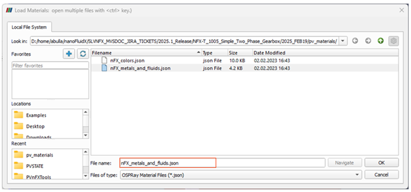

  1. Open ParaView.
  2. From the menu bar, select File > Load Path Tracer Materials.
    Figure 1. Loading the Path Tracer Ray-tracing Engine Materials
  3. Navigate to the material libraries location, select nFX_metal_and_oil_v1.json, and click OK.

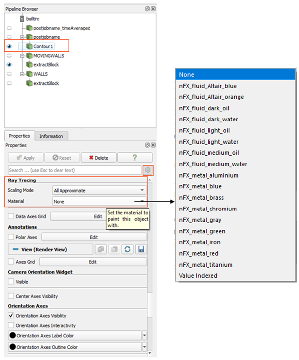

  4. Select the filter you would like to apply on the material.
    1. Optional: Enable advanced properties display.
    2. Under Ray Tracing in the Properties section, set the material.
      Figure 3. Assign Material to Filter

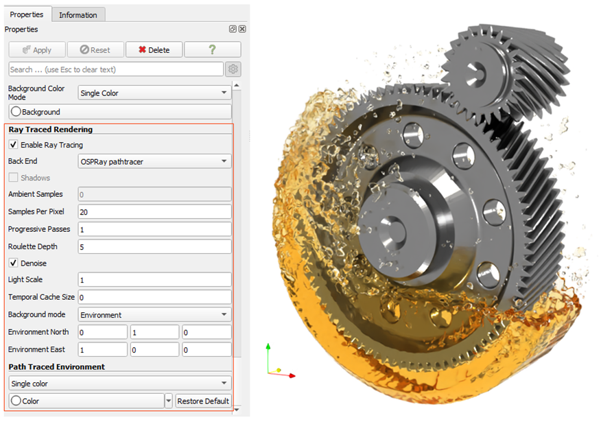

  5. Under Ray Traced Rendering in the Properties section, enable the Enable Ray Tracing checkbox.
