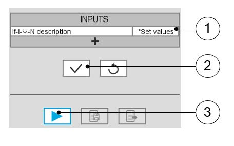

The description must be defined by clicking on the button “Set values”.

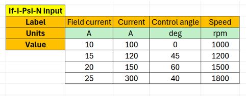

Then, two ways are possible to fill in the table: either filling the table line per line or by importing an Excel file in which all the working points to be considered are defined.
Each working point is described by the following data:
- The field current, or field current density (DC value)
- The line current, or current density (rms value)
- The control angle
- The speed
- There must be at least two working points.
- The speed column must contain increasing speeds.

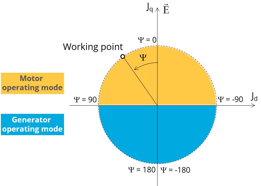

                    Control angle Considering the vector diagram shown below, the “ Control angle ” is the angle between the electromotive force E and the electrical current (J) (Ψ = (E, J)). It is an electrical angle. It must be set in a range of -90 to 90 degrees. This range of values covers all the possible working point in motor convention.
 Definition of the control angle Ψ - Motor convention Note: The number of parallel paths and the winding connection are automatically considered in the results.

| 1 | Click on the button “Set values” of the field “ If, I, Ψ, N description” to define the working points in a dialog box. Refer to the next illustration which shows how to fill the working point table. |
| 2 | Button to validate the user input data |
| 3 | Button to run the computations |

| Excel file template to define the list of working points |

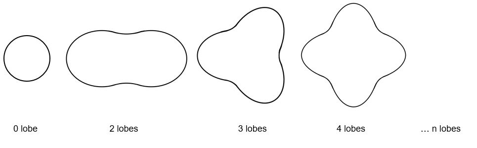

The “ max. mode / spatial order ” ( Maximum mode / spatial order ) input allows the user to define the number of modes to be considered for the acoustic structural analysis. If the user selects 25, it means that the highest number of lobes in the stator deformation will be equal to 25 lobes. All deformations corresponding to more than 25 lobes will be dismissed.
| Number of lobes of the stator mechanical structure |
