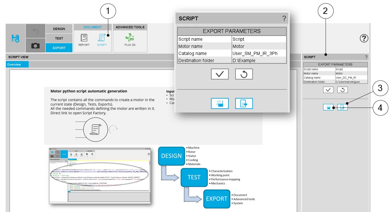

Next to the function “Report”, the function “Script” gives the capability to build and export a python script file, in which all the needed command lines are written to rebuild the considered motor. The script is generated with all the needed sections and sub-sections in Motor Factory, dedicated to the design, the test, and the exports.
Then Script Factory can be used to automate some study such running serial tests or serial design configurations.
Area to build the script export
| Motor Factory – EXPORT AREA – Export a python script | |
| 1 | In Motor Factory select EXPORT / SCRIPT environment. |
| 2 | The EXPORT / SCRIPT environment user inputs allow to define the
                                    name and the location of the new script file + the name of the
                                    motor to be rebuilt from the new python script file, with the
                                    catalog name in which it will be stored. Note: Without defining other names for the
                                        motor and/or the catalog, the original motor would be
                                        overwritten while running the new python script
                                    file. |
| 3 | Button to build and to export the resulting python file. |
| 4 | Button to build and export the resulting python file, and then to open it directly in the Script Factory. |
